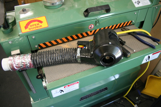

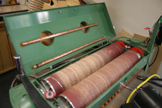

PostPosted: Tue Aug 15, 2006 7:26 am
Here's what I've done. I've got it ripped apart at the moment because the circuit board on the sander took a dump.
This pretty much shows the blower itself. I picked it up at a vacuum cleaner shop.
Here is the plumbing. I wanted to have it blow on the trailing edge of the drums which is why they are placed where they are. The they are angled a bit so they blow the dust backward and the drums kick it up into the DC. Works great.
PostPosted: Tue Aug 15, 2006 7:47 am
Thanks Paul, I guess the blower hose attaches up top where they protrude from the hood? Interesting addition to a great machine...
